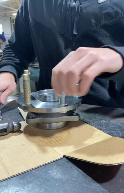

  • Als Anregung/Tip
    Klaus Anger on Instagram: "QUELLE Iinstagram"
    Klaus Anger shared a post on Instagram: "QUELLE Iinstagram". Follow their account to see 32 posts.
    www.instagram.com
    Gruß
    Klaus
